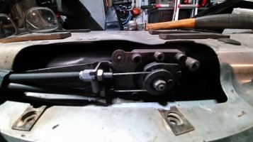

I inspected the exup valve and it was at the 2 o clock position. Tried adjustment with no luck until I discovered the previous owner had the cables in the wrong position. Corrected and adjusted to proper setting and took a quick spin in a short field and hit 10,100. going to adjust primary for 10, 500.
