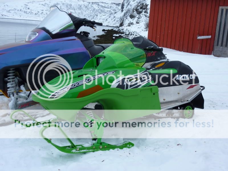

    In 2012 I bought an AC ZR 120 for my kids. That was the year before yamaha painted them blue and started selling them as srx 120`s. If I don`t remember wrong they got yamaha engines in 2011.
    So except for the color it is practically a srx 120.
    Our sled started out green and black, but I did not like the look of it. So I ordered all the green parts available, all from the 2004 model.
    If I had known about the srx coming the next year I probably would have waited for it.
    As for modifications we have none yet, beacuse my girls are satisfied with it. But when they get bigger we may have to get a sharper engine and some risers for the handlebars.
    For anyone in need of tuning parts, recmotor(dot)com is the place to be. They have everything for these mini sleds. (Admin can delete this line if it is not allowed to mention other web sites.. Maybe they are willing to sponsor the 120 part of this site..)
    When we got it:
    [​IMG]
    Modified:
    [​IMG]
