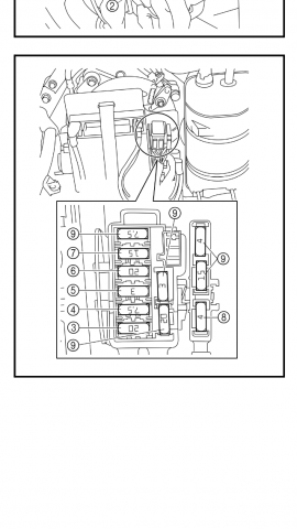

Well, I started to rip into the sled and found that there was zero oil in the chain case. So now I have to pull off the servo to see what to damage is like. I also ran into another problem... when I hit the reverse button nothing happens. There isn't any blinking of lights and or even beeping noise. Is there a fuse for the servo or any other items that would cause that?

Fuse number 8

Thanks, I did check that fuse. On top of the box it says gear. The fuse is good. I was researching and found that some one said hold reset and push reverse. Anyone else hear anything like this?
