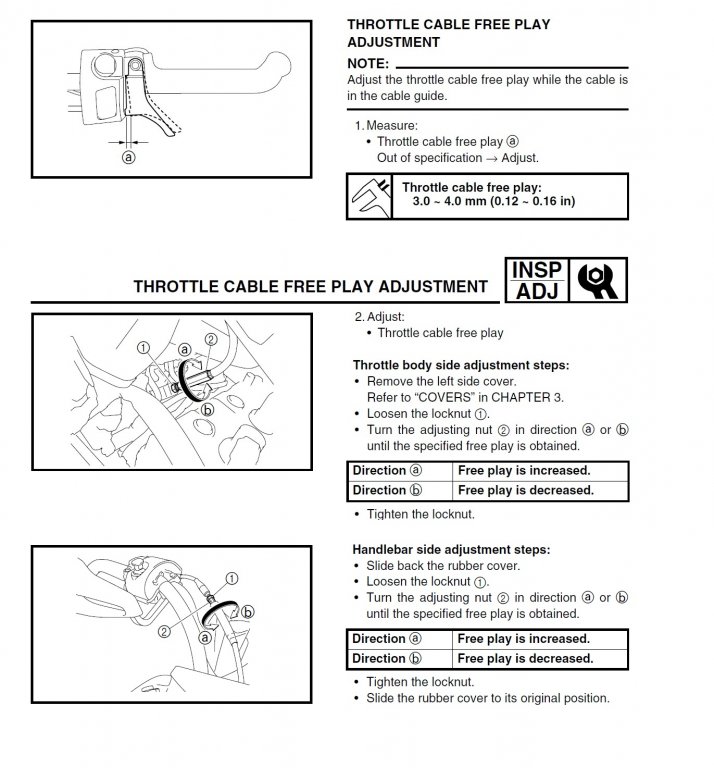

I'm thinking he's got a bad switch on the throttle block or a bad position sensor. Go into the diagnostics and check the throttle position sensor. The procedure is in the FAQs,

Also not starting cause cable is way to tight and engine is trying to start with throttle open so won't. So loosen the cable there needs to be play
Ok I will give that a shot. Thank you. Would this also effect the idle? It seams as if it’s idling low also
