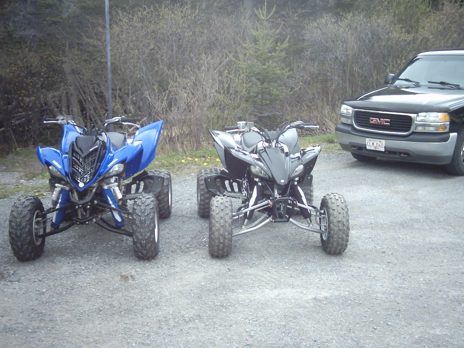

Heres a few pics of my brothers(7 skulls)YFZ450 2012 carb model.The yamaha hour/tach meter was a pretty easy install.Four wraps around the coil with the wire,run it up to the handlebar pad,then into the meter unit which is held on with velcro.Make sure the wire is all the way into the unit or it will read backwards on the RPMs :o| .Looks factory with the yamaha symbol on it.Also had the dealer install a GYT magnetic drain plug(a must on a yfz 450).More to follow soon.
