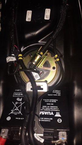

I have a 2015 LTX SE, give me 10 mins and I will get a picture.
I took the picture from standing on the back right (throttle side). I know nothing has been tampered or changed as I have .2 miles on this thing! bought it and havent ridden it yet!!!
THANKS SO MUCH MNMAN BUT THAT IS THE FUEL PUMP I NEED A PICTURE OF THE SENDING UNIT SMALL ROUND TWO WIRE UNIT CLOSER TO THE FRONT OF THAT TANK

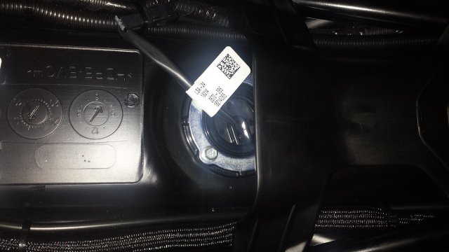

It is in the 2oclock position if you use where the wires come out. There is a raised tab at the 3 oclock position but it is just before that. Again taken at the right side of the sled.
THATS PERFECT MNMAN, FROM WHAT IM LOOKING AT MY SENDING UNIT WAS INSTALLED WRONG. MY SLED WAS COMPLETLY EMPTY JUST BELOW A HALF ON GAUGE. SURPRISED THAT THERE IS NO INDEX MARKINGS BETWEEN UNIT AND TANK AND THATS WHY I NEED A PICTURE
