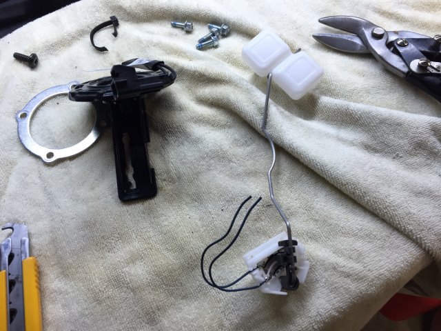

Pics were very helpful, thanks for posting. Pulled my sending unit out and it was uncoupled but wires still connected. Reassembled with Ty wrap. All is well again.Similar experience to ViperBill, except the wires broke off the sender unit also...when I removed the unit all I had was the mountng plate (top piece); the float and the sending unit and the wires were somewhere in the fuel tank...took about an hour to fish it out. But, re soldered the wires, put a couple zip ties on the sending unit and now it works...great!. Nothing like getting 1 year out of a fuel sending unit...pos.
View attachment 115596 View attachment 115597
