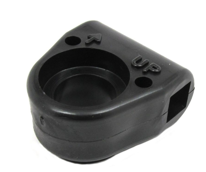

I too need a rear shock for my 16 Viper. Did you have to remove the piece below that holds the torsion spring to get it out?I am sure Steve is right and pulling the skid is best, but you can get the shocks out without pulling the skid on an LTX. I did it last year on my LTX. The center shock is easy, but in order to get the top bolt out of the rear shock, I had to remove the torsion spring from one side of the sled, the side with the head of the bolt, so that I had room to slide the bolt out and release the shock. I am no mechanic, so it took me a while to do it, but it really wasn't all that bad. Getting the shocks back in was frustrating until I realized I could use a ratchet strap to compress things until they fit!
