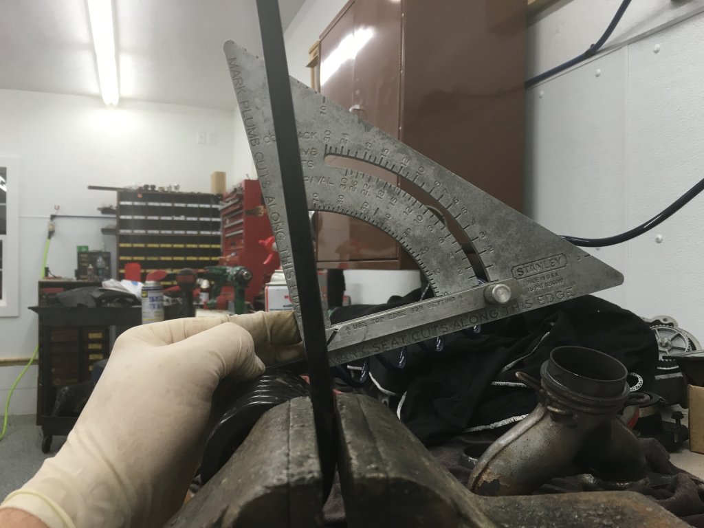

The 2014 LTX rear torsion spring where very stiff.
There was quite a discussion here when those sleds came out.
I re-bent mine to achieve a more compliant ride.
These are pictures of the before and after spring angles from 2015

STAIN
- Feb 29, 2004
- 4,604
- 3,856
- 1,713
- Vermont
- 2024 Arctic Cat Riot 9000
- Vermont
After a revalve from Hygear on all 4 shocks, dual rate springs up front and in the center shock, like a couch. It sucked up all the trail chatter like it wasn't even there. Those front springs were very stiff also.I learned something today....sorry PAvector. Here is what I'm going off, in our group there 2 14 Vipers one an RTX and the other an LTX and 2 16 Vipers one a RTX and the other an LTX. The kid that rides the 14 LTX is 175# in street clothes and he's never complained once about it bucking or bottoming. The 3 other machines all use the same torsion springs, can't believe I never noticed those torsion springs on the 14 LTX are that much different. We had to do major work on that skid this past off season, he broke the upper cross bar which basically destroyed the suspension, rails, W arms, center shock and more. Stain that's taking a lot of preload out of that spring, how did it ride afterwards?
That sled went from being the stiffest sled to the best riding sled I owned after those changes.
It was Hygear who told me to bend that spring from 90degrees to @110degrees. They where doing the same thing at the time. They did not have any softer springs at the time.
I need to get my Sidewinder to ride like that Viper did.....

Based on STAIN comments, I might look at bending the springs to reduce the preload, then I can put the preload blocks to 2 or 3 when saddlebaging. But maybe going to the 16 springs would accomplish the same?
STAIN
- Feb 29, 2004
- 4,604
- 3,856
- 1,713
- Vermont
- Vermont
I would get lighter springs. If Yamaha doesn't have them, then Cat might.
