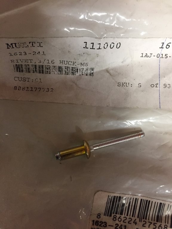

Yes these steel shafts are on the list for next year. The chassis seems to be showing signs on the 3 rivets on each side of the sled under the front part of the seat where the braces/ supports from the steering column come back and mount the the tunnel. Paint has chipped off and aluminum dust is appearing on my white painted tunnel. Over time these rivets will become loose so I am trying to avoid this from happening. Anybody have any ideas to help prevent this from happening?
I am afraid you will eventually see that on almost all the rivets. When mine actually get loose enough to rattle I put new ones in with a washer backer where possible. Use the good ones from Yamaha or these Huck rivets are even better. That’s what those 3 are and even though the paint has gotten ugly around them mine haven’t loosened.
