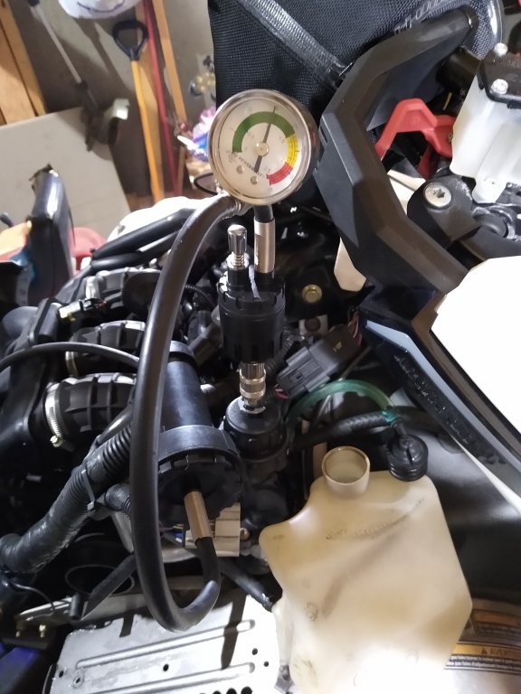

It had been suggested if I had a bad head gasket to pressurize the cooling system and if it's not leaking externally it's leaking internally. I would possibly see air bubbles coming back through the recovery tank. In 1 hour the gauge is down over a pound. But I'm chasing more external leaks now. Very inconclusive

if it was a head gasket you would be pushing coolant. Likely the water pump failed if it’s overheating like that.It had been suggested if I had a bad head gasket to pressurize the cooling system and if it's not leaking externally it's leaking internally. I would possibly see air bubbles coming back through the recovery tank. In 5 minutes the gauge is down 1/10 of a pound no air bubbles in the recovery tank
I suppose it wouldn't hurt to replace both the water pump and thermostat. I just wanted to verify the head gaskets integrity, so I don't start the season on a sour note next year.
