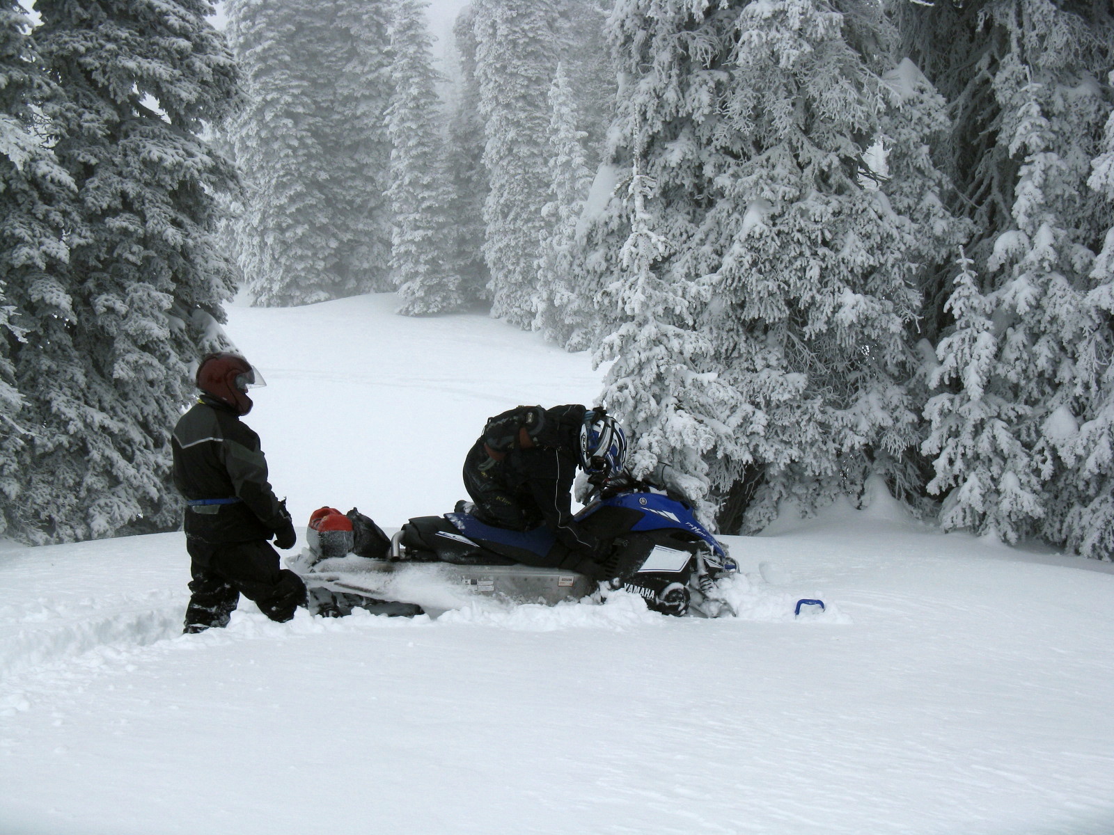

I did find the problem with my sled today. The wires for the right fuel injector had vibrated and rubbed through the wire covering and were shorting out on the SLP pipe heat shield under the Y pipe. It was super easy to fix once I removed the heat shield for a look. It started the first pull after I retaped and rerouted the the wires. Yippe!
