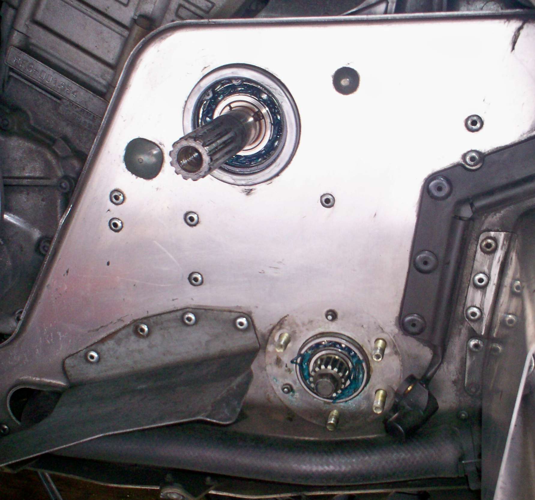

Here are some pictures of the bearings on my 04 Warrior with the seals removed and grease applied before refitting the seals, and the Grease Gun with a homemade attachment for applying the grease!
These bearings are original with over 9200 miles on them. I use Amsoil Waterproof Synthetic Grease.
These bearings are still in excellent condition! ;)!
"Lubrication Is The Key" :drink:

do you just stick the needle inbetween the ball bearings and pack as much grease in as possible?? and are the seals easy to take off and replace. Im not sure exactly how they come off???
Also what bearings do you do this to. Just the one pictured or others??
Thanks!!
Thanks!!
I pump a line of grease around the bearing and then rotate the track and press it in with my finger on both bearings and then replace the seals.
To remove the seals, take a tiny screwdriver and get it behind the seal on the inside diameter being careful not to puncture the rubber, what you want to do is slip the screwdriver under the seal, then take a little larger screwdriver and slip that in where the other driver is and work your way around the seal and it will pop out.
To replace, put the seal back on and press it in with your fingers, going around the bearing. These bearings I check and lube before each of my weeklong trips to Quebec.
I also do all the wheel bearings once a year.

DITTO, Just take your time and be careful and you won't damage them.
