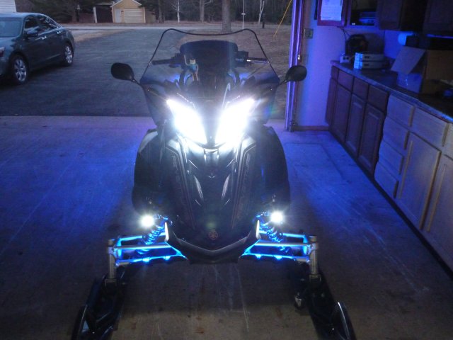

If you're still running the stock headlight you (at 5ow each), you could convert to HID's (at 35w each) and then have the "room" for about any accessory you want to add (and have real headlights that are 20x brighter). Changing to HIDs I run two 10w driving lights, 7" Garmin, at least 300 LEDs, hot grips & electric shield with NO problems. The 10w driving lights is plenty, each of them produce 900 lumens.

Those little 10w lights are actually as bright or brighter then my HIDs.
Check superbrightleds.com
The battery can suffer when you overload the system but it only suffers because the stator can not keep up with the demand. I would be hesitant to load up another 50 watts if running the stock headlights.
With a HID kit you may not need that extra 50w light.
I added 10w Solo lights like THKSNOW has with my HID's. They work great. I have mine turned to the side slightly so they shine into the corners.

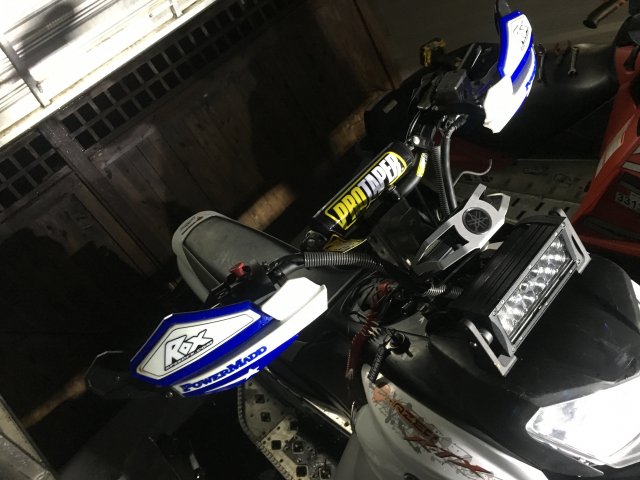

I run a phone charger, rsi heated grips an 8" 36watt light bar with holgen high beams and 8k hid low beams along with a heated shield cord on my phazer. No bad effects yet and the light bar is the best light on the trail. My bar was 20 bucks off amazon hooked up directly to the highbeams

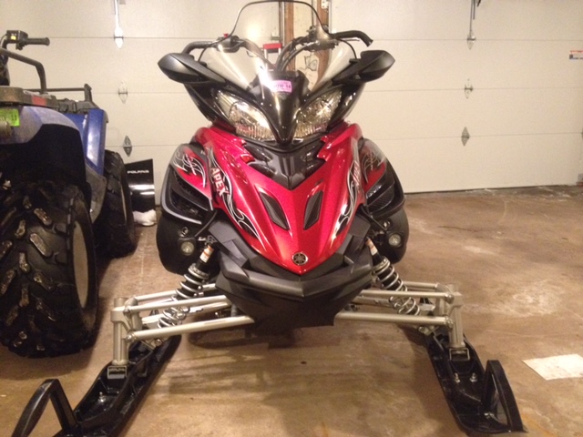

I have some on my 2011 Apex. I mounted them on the reflector mounts. No drilling etc..
