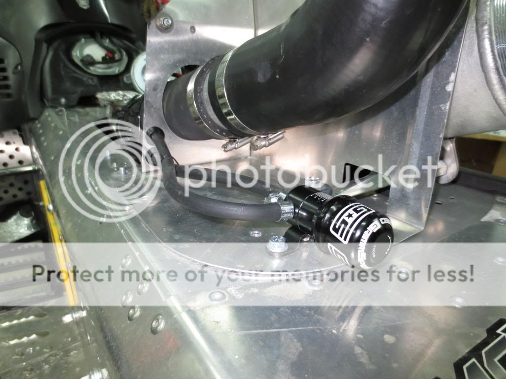

Now there is no way back, I installed the manual boostcontroller today:)
(well hehe, I didn't remove the TCV I just disconnected it and plugged it with a hose so that I can go back to it without much effort)
Here`s how it turned out:
Maybe a little too far out, could have placed it somewhat longer in but we`ll see.
Can`t wait to try this!
Maybe there will be some testing this weekend, some people say it is possible to make it up to somewhat higher elevation on the island where I come from, but there is very little snow at sea level. Will keep you posted:)

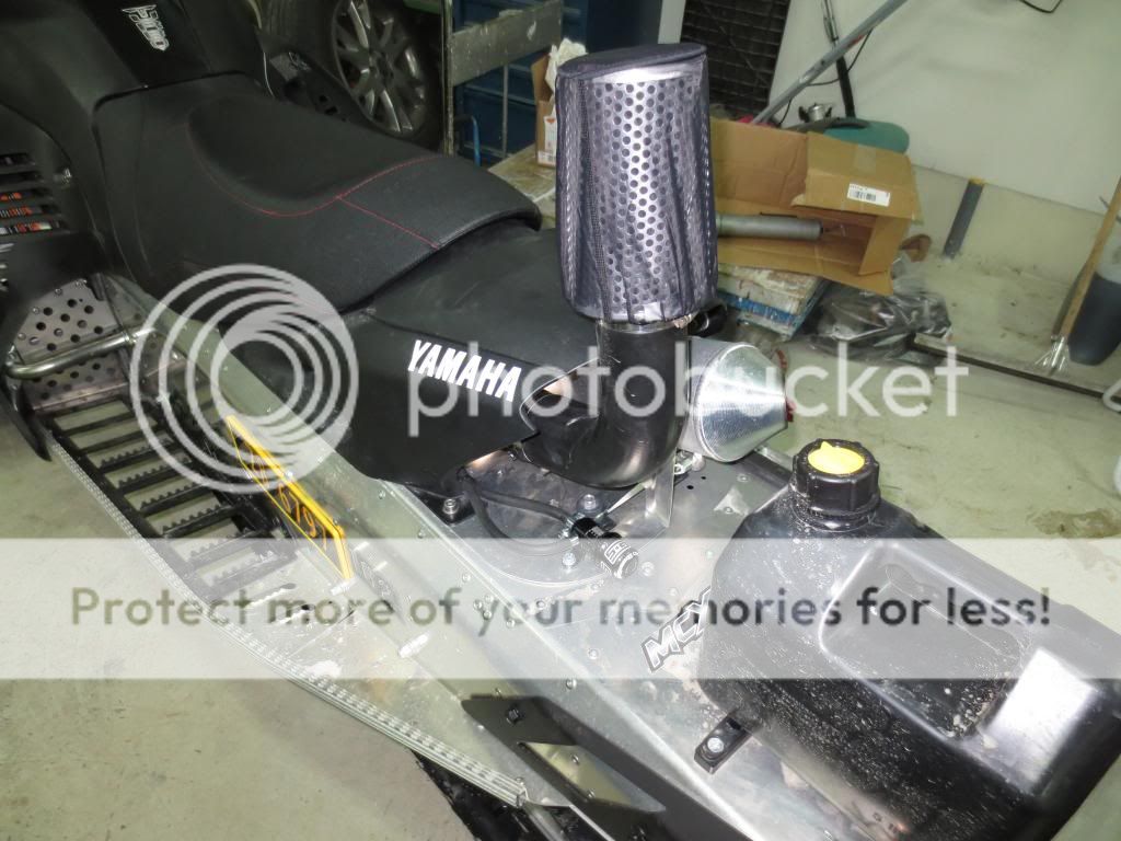

OH btw sorry for the dirty sled, trailered it without the cover:/
