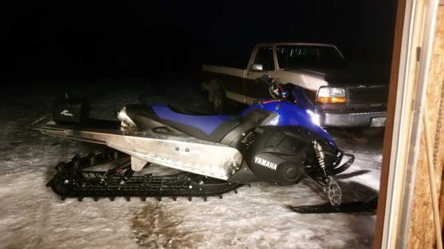

Awesome! I did xtx to mtx as well. Wish I would've had the extra money for a kmod, but did the rmk 155 with a 2.6x162 powerclaw. 7 tooth 3.0 drivers, and barcode 365 kit up front.

Sweet sled. I hope I am not hijacking this thread but since you just converted yours I thought you might know that answer. I am looking at buying a Nytro MTX or XTX and I was wondering if you know what is the difference/mechanism is that makes the MTX's narrower ski stance versus the XTX or RTX? Is it different A-arms, frame, spindles or just spacers on the skis?
..SNAKEBIT..
depends on year but a-arms are the big difference, I think some spindles are also different

Do any of you guys know? I have a 13 xtx and would like to install a Yamaha 153 suspension and a 2.25 track. Do i use the same bolt holes in the tunnel? I have the track,suspension and drivers

Did you have to do a whole lot special to fit that 16" wide track under there?Got the conversion done. Took a little bit of patience but think it turned out good. Just need to find the right gearing/ chain length and clutching for revy. Maybe a tunnel dump?
K- mod with raptor shocks ice age rails
163 by 16 by 2.5 peak track
7 tooth drivers 2.86 pitch
..SNAKEBIT..
I ground down all tunnel rivets to one bulge.
need modify or replace rear suspension brackets
