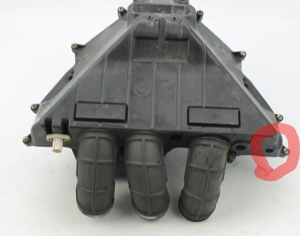

Hey everyone. I need a little help. I am reinstalling my air box and i cannot remember which hose went into the exhaust side of the air box. i know the second one from the exhaust is oil spearator but what is the one closest to the exhaust side? I removed the air box a while back, finally had some time to put it back together and I am having a mental blank spot.
I believe its the aluminum one from breather box. LOL mines off yet too.

the aluminum one is the second one in from the exhaust side......the one i cant remember is the first one. i cant see a hose or tube that goes to it. driving me nuts......or maybe i need better lighting in my Sled Shed to see better.I believe its the aluminum one from breather box. LOL mines off yet too.
It a black hose that comes from down on the motor area. Look a the pick of the air box in this link, maybe it drop down on you. you can see the black hose to the far left on pic in this link. https://ty4stroke.com/threads/air-box-mod.129365/

I will have to have a closer look and dig deeper. The only hose I can find that looks like that going nowhere is the coolant overflow which I thought just sat on the access panel on the floor. I believe you may be correct that it has just fallen down. I was working with Marginal lighting, so must have missed it. Will report back.It a black hose that comes from down on the motor area. Look a the pick of the air box in this link, maybe it drop down on you. you can see the black hose to the far left on pic in this link. https://ty4stroke.com/threads/air-box-mod.129365/

It would be coming out from behind your chain case area.I will have to have a closer look and dig deeper. The only hose I can find that looks like that going nowhere is the coolant overflow which I thought just sat on the access panel on the floor. I believe you may be correct that it has just fallen down. I was working with Marginal lighting, so must have missed it. Will report back.

Perfect! When i get back to my cottage and work at finishing my maintenance I will look there and see what i missed.It would be coming out from behind your chain case area.
The rubber hose comes from the top of the valvecover.
