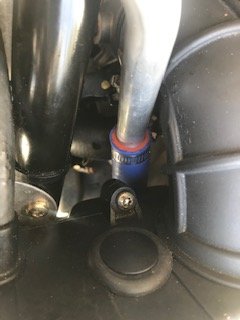

I too have a oil in the airbox issue with my 2018 Viper and not from overfilling or a roll over. Does anyone think there would be issues by plugging the airbox hole that the separator tube goes into and attaching a hose to that tube and running it out the bottom of the sled thereby bypassing the airbox?
Is this just a light film you are talking about?I too have a oil in the airbox issue with my 2018 Viper and not from overfilling or a roll over. Does anyone think there would be issues by plugging the airbox hole that the separator tube goes into and attaching a hose to that tube and running it out the bottom of the sled thereby bypassing the airbox?

Pretty much but there is some small pooling in the the lower corners in the airbox and there is some oil residue outside below the airbox on multiple surfaces, I pulled it out the airbox and don't see any other source of leaking. I'm bypassing the airbox andIs this just a light film you are talking about?
I suspect those who didn’t roll it or overfilled had the checkball stick in the separated above the exhaust if oil is dripping out air box. That should be cleaned with Dishsoap and water.
