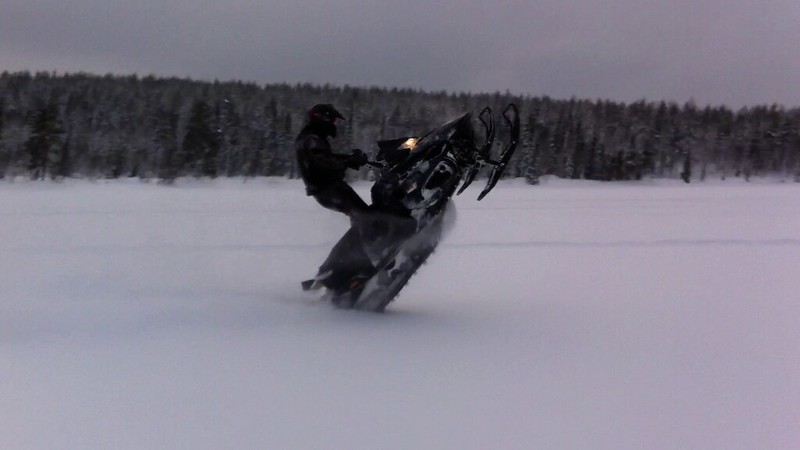

Man im glad i finally found this.
Made my Tapex Gt 121-144 but it trenches to much for my taste, it wheelies at all command and i love it.
So im considering to get the 121-136 instead and do your mod + anti stab.
My concerns are that it will be to unstable in higher speeds and heavy on the stearing at hard packed trail since moving the skid back.
What would you say?
as for your mountings are there excactly 4" back and 3/4" down? and are the down forced due to moving back the mounts so you put the in the top of the tunnel.
The cost for me will be new 121-136 muffinworks + some stab kit, but which one? and were exactly to put it?
