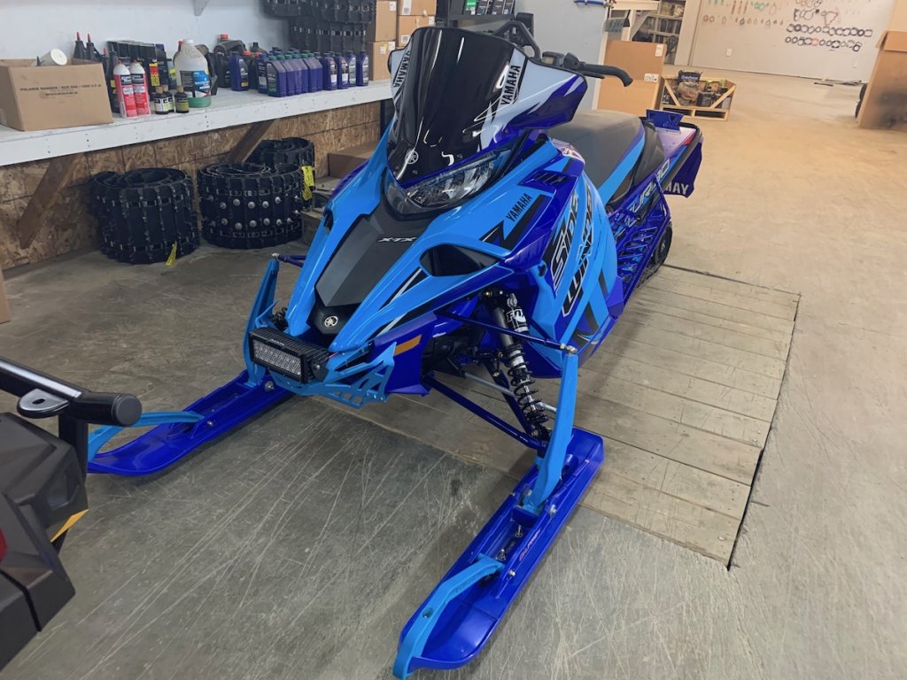

Thanks for the wiring/relay info!
Here's the initial setup for the TAPP primary and Pro-4 secondary:
Primary is black spring, +2 rollers, 2 hex bolts on 2 opposing arms, ramps on A.
Secondary is 46/36 helix with dalton white spring
Testing to commence shortly...

Unfortunately, winter ran out before the sled's build was complete. But, it has since been finished, except for receipt and installation of the Hygear shocks, F & R, which should happen within the next month. Testing will begin as soon as the snow flies!
It'll be running Dave's new closed-loop system too

I like the LED “mogul light” where did ya get it?
mainedrummer
- Apr 13, 2019
- 149
- 113
- 353
- Up North
- Yamaha Sidewinder
mainedrummer
- Apr 13, 2019
- 149
- 113
- 353
- Up North
- Yamaha Sidewinder
I'll be installing an iPad Mini up on the dash for the CoPiTrail, and a Garmin GPS in its handlebar mount, as soon as its time to start testing on the snow
Also installing a Skinz Stealth Heated and Adjustable brake lever this week:
- 5,706
- 4,306
The wheelie machine!Yes, summer has been long, but I've been pre-occupied riding this:
The light is a Rigid Industries 6" E-Series Pro, Diffused Driving, and I bought it here LINK
