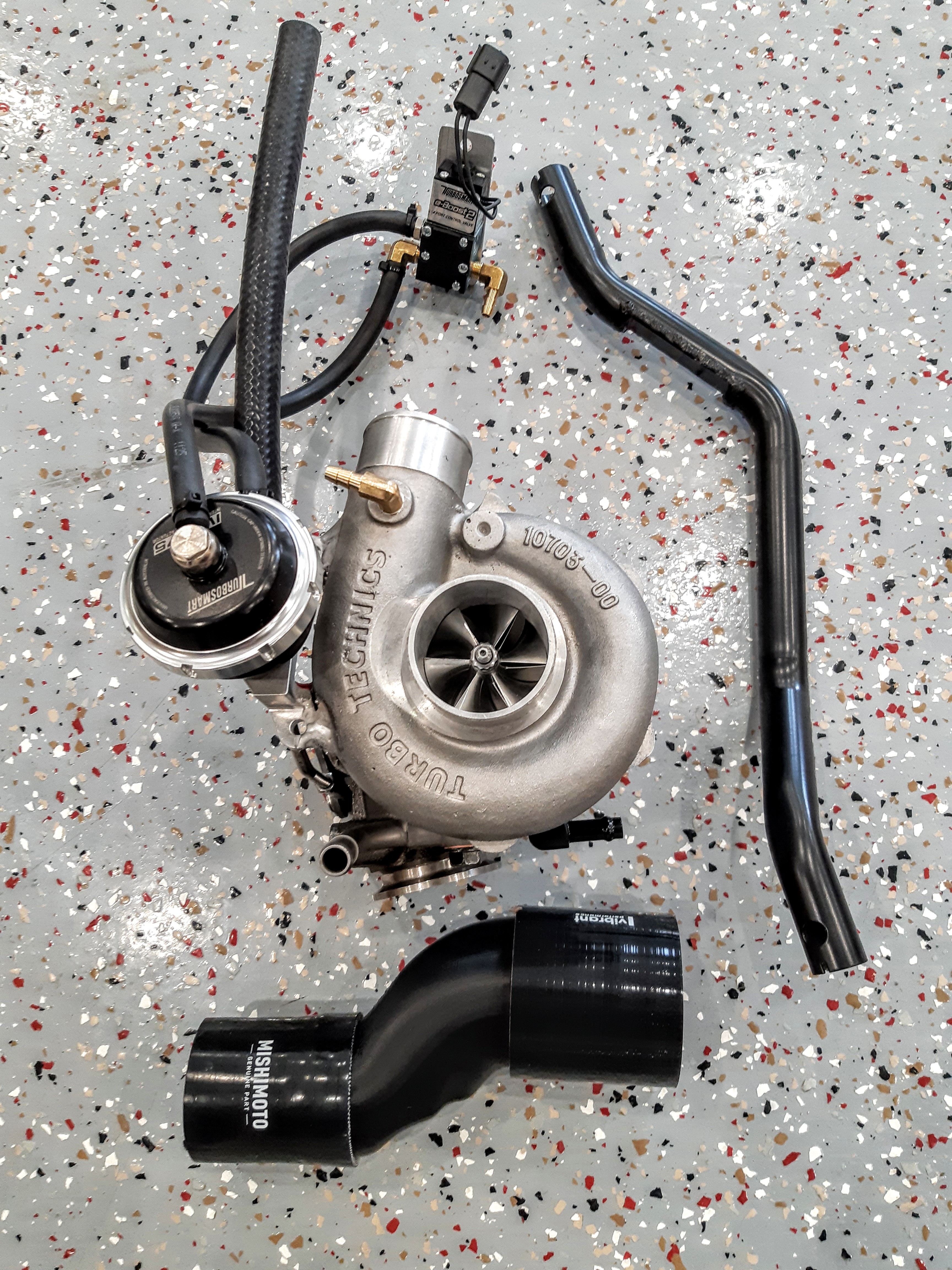

Thanks! It's looking like it'll be HP Wars on the trails this winter. I'm hearing about a few other sleds that are making 350 - 475 HP.
I'm not worried though, I'll be making a "little" more with VP Import in the tank. Stay tuned!![]()
More than 475? Yikes! What turbocharger are you running?
