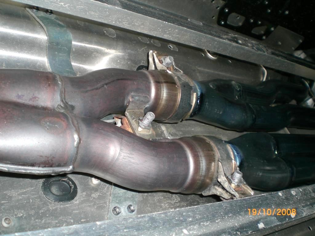

Let me get this right... The donuts are between the flange pipes and y pipes where the clamps are??? If so, there is no number on the microfiche for this part, or is it actually part of the flex pipe??

It should be part #4 Gasket, Exhaust Pipe 8FA-14623-00-00 on the fiche.

All '08 and newer APEX'S have the updated header & exhaust extra centre support, thats the ONLY change they have made so far on the exhaust system...its still the same donuts as previous models and everything else.
click on link to see the support I'm talking about...
http://www.ty4stroke.com/download.php?id=50305

mine went last year wirh 2800 miles. donuts destroyed as well as pipes. thankfully it still had warranty. if you can check out your donuts when you start to hear backfiring its a good idea. 1 or 2 donnuts are better than replacing the pipes. yamaha needs a solution for these poor pipes. instead of loosing 1 pound by changing the type of metal, they should go with the rx-1 pipes.

Can this support be retrofitted to an 06 or 07 apex? I'm looking for something as a long term fix. 7500 miles on my sleds and in for repair twice for exhaust problems
15,000mls, replaced everything, heat shields, headers and manifolds.

We took my son's 06 Apex apart and found that the bad donut had a loose clamp. All the rest were OK.
Had to grind the stop off a bit to make the clamp tighten (read about that trick on another post on TY). Maybe clamp tightness is part of the problem.

The "y" pipes appear to be the same from 06 to 08. the muffler looks different because the 08 had the mount welded between the pipes.
Thanks apltx08 for the '08 picture!
