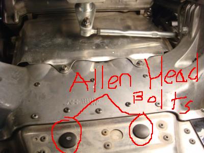

I just did this to my sled. There is a heat shield which the y-pipes are connected to between the tunnel and the pipes. There are two bolts with allen key heads which connect the y-pipes to the heat shield. These were really hard for me to break loose. A lot of people say they heat the bolts up but I just drilled the heads out because I am not reinstalling that heatshield/bracket. But in order to get these pipes to come off that bracket you have to slide the y-pipes towards the front of the sled to get them to unhook from this heatshield/bracket. I found that unbolting the rear suspension and having someone lift the tunnel up so I could get underneath helped a lot.

yeah but one thing to check before you unbolt everything is the two allen key bolts you need to removed near the front of the y-pipes. They tie the y-pipes to the top of the tunnel. I would try and get these two bolts loose before unbolting everything else. In my case they were so rusted and heat treated on that I had to drill them out. after you get those two bolts out then removed the muffler and loosen the clamps on the headers. From underneath the tunnel take the left y-pipe out first (left looking at the rear of the sled) then the right. You will have to push the y-pipes like I said earlier towards the front of the sled then out the back... they have a little hook then there you ahve to get undone. The below picture sure where the allen head bolts are located underneath the rubber gromets.
