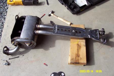

Can't take credit for this but I picked up this a while back searching this awesome site when contemplating gutting mine or going with Whiteknuckle. I decided to go with a QC-1

Thanks, that is a great pic! Can all of that stuff come out? Could I make the whole canister smaller, and just duct the exhaust out the stock holes?
