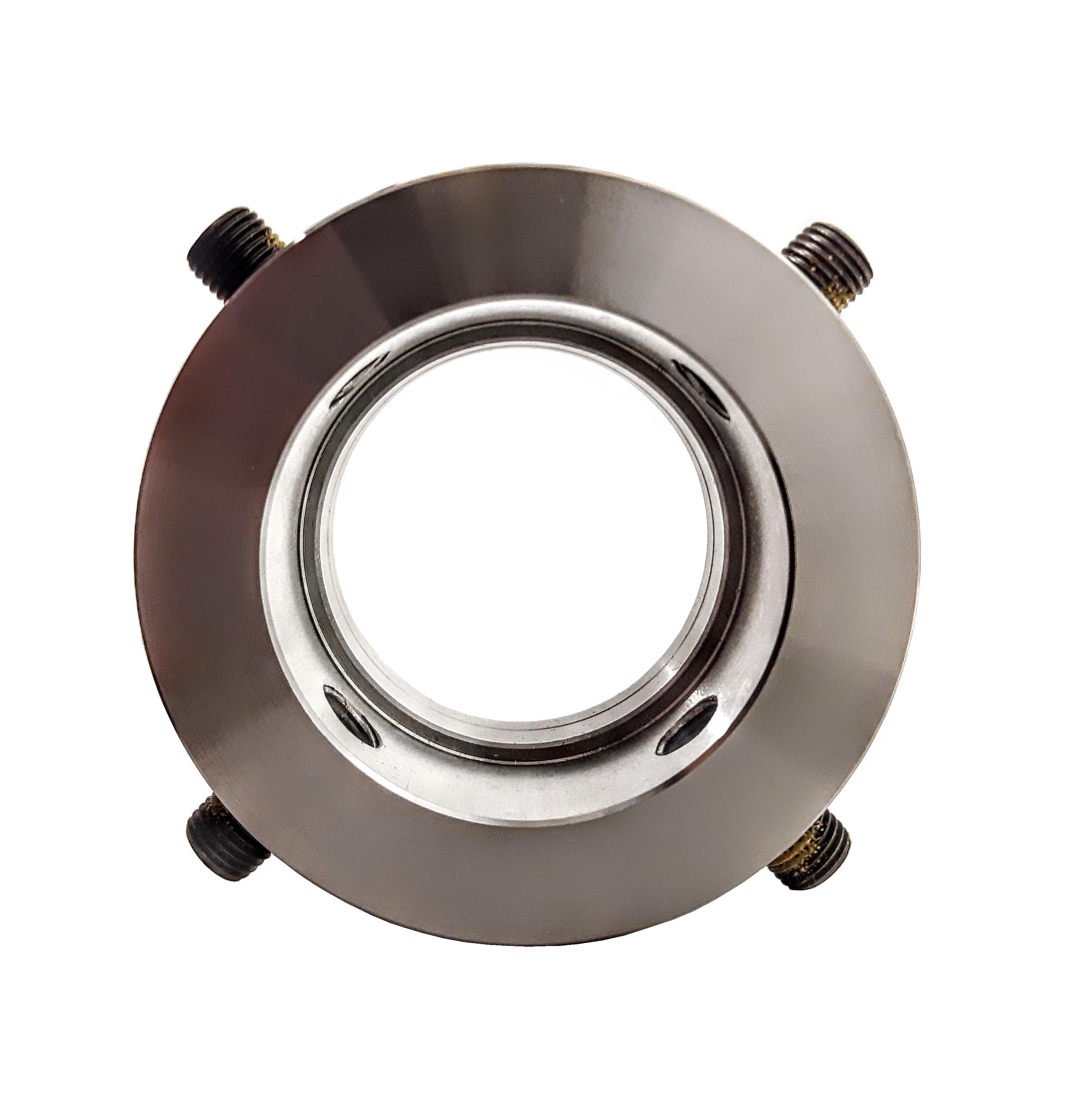

Did this ring take the place of the stub shafts you guys had?Noise Reduction Ring Archives - Hurricane Performance
hurricaneperformance.ca
the Hurricane clutch noise reduction ring quiets the clutch by absorbing the engine harmonics the cause the noise. This has been a popular item that makes a dramatic difference
When you click on that picture on your site is says " no results found"
HURRICANE
Yes. We had trouble making the stub shafts so we redesigned it to make the noise reduction ring to fit the stock stub shaft. It’s now been flawless for a season and it allowed us to lower the price.
thanks for pointing out the issue with the website. I’ll fix it tomorrow

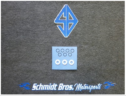

Teamblue4 is correct, we have the cryogenic anti-movement washers that keep the roller pins and bolts from moving.Check out Thunder products they have a kit also, worked awesome on my Apex's.
These are for any Yamaha primary clutch that has been manufactured without the little allen screws to hold the roller pins in place (2010 and up)
Here is a test, go out to your sled, if you can move the roller pin bolt back and forth, you should be using our TSK-545 cryogenic washers to keep the parts from moving. This also cuts down on the rattle noise.
***Important thing here it that the roller pin and bolt quit moving as metal to metal contact has really started a wear problem on the clutches I have been receiving for inspection and/or repair.***
These are $9.95 retail for the set of 3 and you can get these at the snow shows for $8.00 cash
Washers are reusable! So if you replace rollers down the road, these washers can be re-used time and time again.

JOKE!Any more input of this kit on Sidewinders? Does it last? Strange that some says it makes a big difference some say not much...
Big fat joke!
Was 10% quieter for hour or so.
He also convinced me to buy his "Super Duper Schmidt Spring" cuz everyone else was wrong on how to tune these clutches.
Belt blew in 30 miles.

What happened to the stub shaft fix for this?
HURRICANE
Hurricane Clutch Noise Reduction Ring - Hurricane Performance
The Hurricane Clutch Noise Reduction Ring dramatically reduces the clutch rattle in the Yamaha/Sidewinder by absorbing much of the engine harmonics before the clutch taper. The install process is simple. Remove the outer bearing from the stock PTO stub. Install the Noise Reduction Ring on shaft...
justinator
I have the noise reduction ring on my winder. It works as advertised. Still a little bit of noise but greatly reduced and find the rattle disappears quicker as rpms increase vs stock.
