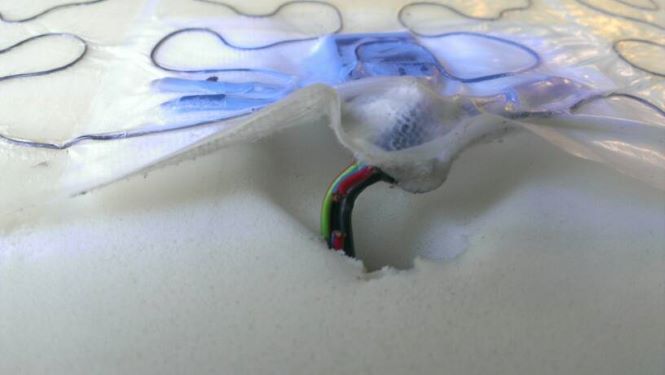

Hi yamahamarc, what ended up being your problem here?

All too common issue. Shorted/broken wires at/near chip.

Near chip?All too common issue. Shorted/broken wires at/near chip.

???? X2…. Near chip?All too common issue. Shorted/broken wires at/near chip.

The chip I'm referring to is on the heater pad that's underneath the seat cover. It's an electrical part that controls the electricity to the pad. Most of the time, the leads going into the chip break because the design causes those leads to flex as the rider goes up and down. Eventually they break.

The one and only time I rode double, it was a very short ride with my wife, I found that my heated seat wouldn’t work on my next Day ride. It was taken care of by dealership through warranty, but nice to know what probably happened for next time when it’ll be me fixing it! Dealership brought my seat to a local Upholstery shop along with new seat element.The chip I'm referring to is on the heater pad that's underneath the seat cover. It's an electrical part that controls the electricity to the pad. Most of the time, the leads going into the chip break because the design causes those leads to flex as the rider goes up and down. Eventually they break.
