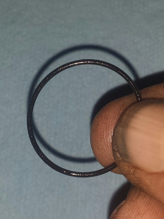

Took apart my chaincaase today to install new track. Took special care to keep all washers, spacers etc in order. But when I was looking over the chaincase bearings, I noticed this little O ring sitting on top of my outer case...have spent an hour trying to find its home with no luck. Anyone know where it's aupposed to go??

No...I haven't taken the gears off yet...so it wouldnt be that.

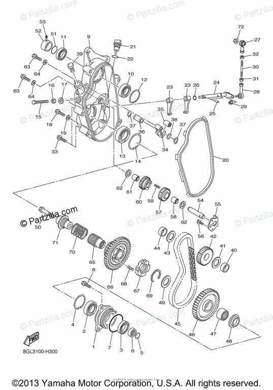

Was looking at the fiche earlier and wondering if it's #51
Got it all back together, and yeah that little O ring plopped out when I took off the chain case and was sitting on top of the outer case. Easy to miss if you've forgotten where it sits.
