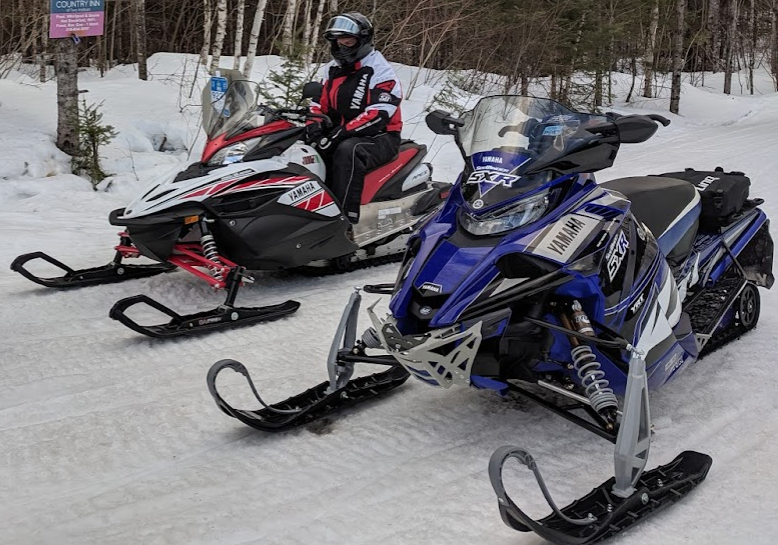

yamamarc....I haven't seen the Slydog Command ski yet, but we've been running Slydog Attack ski's on our 'Winders for quite a few seasons with great results. My wife loves the handling and light steering feel on her '18 LTX-LE with Studboy 7.5" carbides. Highly recommend the Slydogs.
How do you find the Attack skis on hardpack?! I currently have the command skis and they are great in loose snow, but in hardpack they become twitchy and grab too much. I wonder if the attack would be a better all around ski than the command that can handle hard pack better?
