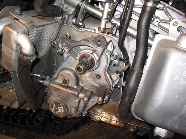

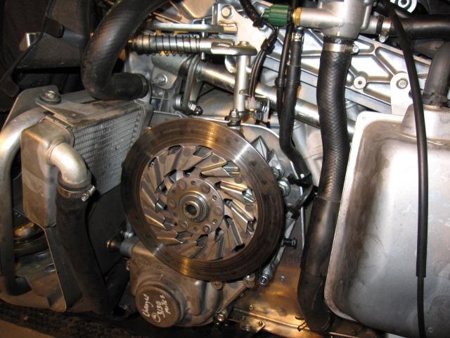

I was changing a track on a 2011 and I saw some really cool changes. There is a new support bolt for the chain tensioner that runs through the cover. Also there is a retaining ring on the bottom bolt inner race to prevent the bolt from shooting thru the cover if not tightened properly on the reverse gear.
Here are some pics.
