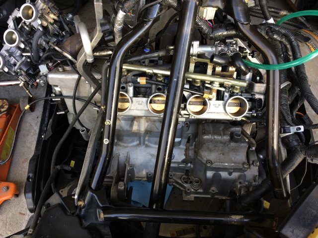

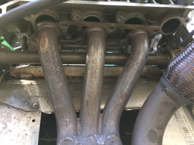

I just bought a viper with the motor out of it and was thinking about putting the apex motor in, but the motor hits the chain case on the right rear side, one throttle body will interfere with the brace on the right and exhaust would be about 1/4 inch from chain case seal. I took some pictures and motor still has to come back an inch to rear mounts - It may be possible to do but would be a lot of work and modification to chassis.
come on you don't have anything better to do right now! That frame brace was overkill anyhow cut it out. maybe make straight header that dumps und the seat for warmth. Notch the chain case and use that oil that they used to run commercials would run an engine for hours with no oil in it. And for the motor mounts, I once saw some Brits tie a motor back in a Jaguar prototype at Watkins glen with a coat hanger - Boom your done!
