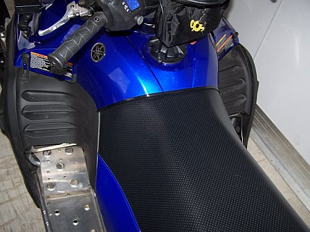

Well I got it done today. I had to cut the wires and install my own wiring for the brake light. I used a 4 flat trailer wiring connections to make sure they wont come apart. I also used some rubber tape on all connections and finished with nylon snake wrap on the wiring as well. Drilled a hole in the bottom of the tool box in the seat and took off the plastic covering the rear brake entry from the tool box. If you look you will see where Yamaha has slots to run your wires for the brake light. Ran the wires through the hole I drilled up on the side of the tool box and into the brake light entry hole, then replaced the plastic peice that covers that hole. If you look at the pictures I also went to Canadian tire and purchased some black door trim to put on the gas tank shroud where I cut it to give it a professional look. Use the kind that just clips on and has built in adhesive on the inside of it. Now if I get the new Ad Boivin ZX2 suspension I will be oh so styling on the trails. The extra room in the back of the seat is going to be real nice as well. I am very happy with the way this has turned out. Special thanks to member twomorestrokes for sending me the paper template for cutting the gas shroud made things a lot easier.

pics aren't there just boxes with x's in them?
Again man I hate kodak software. I wil try something different. You should be able to see them now.

good Job Sled Dog,
It will sure look good with the ZX-2 !!!
Work's now look's great.
TT
Looks very good Sled Dog! You will love this upgrade - it's like getting a new sled.
