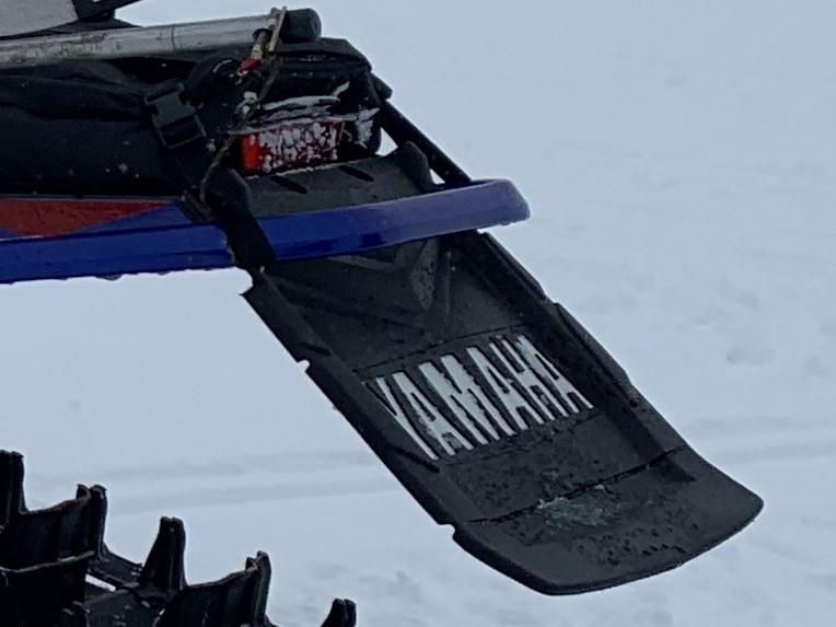

Im not good at resizing to post here. But if it works you can see the stock flap and Tail Light taking up the space between tunnel and bumper where you'd need to put ur hands when stuck. Stock snow flap is worthless for mountain or deep powder riding. My sled spends a lot of time wheeling bending the stock flap out and besides looking stupid sticking out the rivets come loose.
Not a great pic of the tail light relocation but you can def see it moved forward on the tunnel. Lincoln County Customs in Alpine WY, sells the kits.

look like the snow flap fit great. loved the one on my apex, lot of flex in powder.
