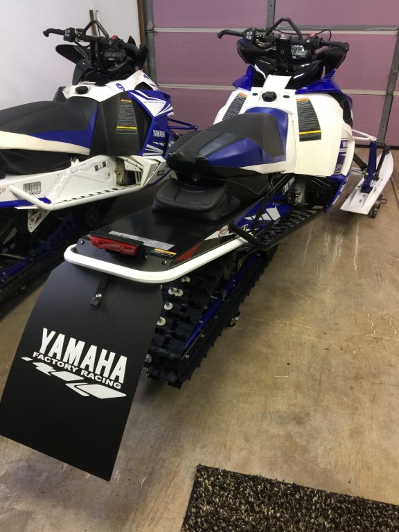

Ordered the Proven Designs 28" race snow flap.
Thanks for the info!

Have any pics of the snow flap installed?

Sled is sitting on rollers. The snow flap just touches the ground when not on rollers.
