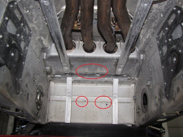

I have been running my track just tight enough ( 1-1.25" with no weight) so it does not ratchet. The track is the stock Ripsaw with Woody's 1.325 studs @2 per row.
Changing the track this season I found damage on the front exchanger and bulkhead from the studs. I have modified protectors to compensate for studs but did not anticipate anything could happen up in the front as the track would be tight enough as its pulled around the tight 9" radius. Wrong. In the pic you can see where the studs are hitting. I will be running the new track tighter
Changing the track this season I found damage on the front exchanger and bulkhead from the studs. I have modified protectors to compensate for studs but did not anticipate anything could happen up in the front as the track would be tight enough as its pulled around the tight 9" radius. Wrong. In the pic you can see where the studs are hitting. I will be running the new track tighter.View attachment 103668
Steiner, maybe it's just my eyes (likely) but I can't see anything that looks like damage in your pic? I also assume you track is a 136"? In that case, I'd suspect it would balloon slightly more, which would warrant having the track a little tighter, especially if you do a lot of high speed runs?
Edited the pic. If you look where the red circles are you can see the scratch lines from the studs.
Sorry, wish I knew how to make the pic bigger here on the forum.

Thanks Steiner. I will be sure to double check mine again, but I don't believe I have any marks/damage caused by the studs?
I am strictly trail with very few high speed runs, and a 121 so maybe that is why I have gotten lucky?
