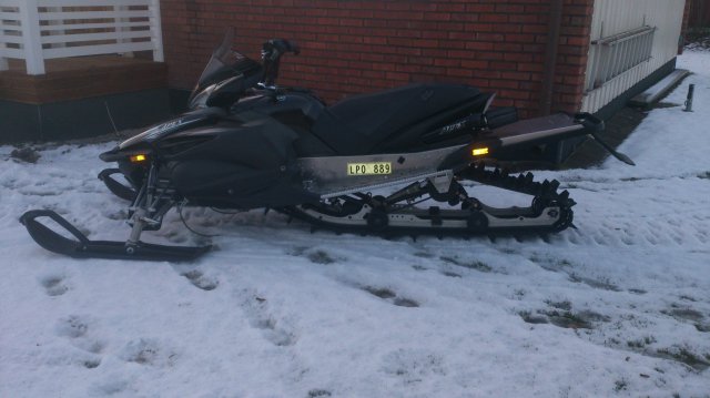

I built a mtx apex of a 2011 se, put a apex mtx suspension in it. Put a wrp set on it and its real firma i like it.
Mcx 290 kit. What a nice sled it become.
Did you use the apex mtx throttle cable on your sled? Please post some pics of your sled

That looks perfectView attachment 118021 No i used stock cabel
