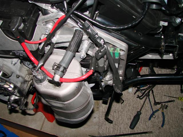

To the right of you battery is where the solenoid is located. Find the large green fuse and its to the left of that. You'll see a large red lead on the left and a black lead on the right.
With the key in the ON position all you have to do is complete the circuit between them using whatever you have that is conductive. When you do this you are by passing the "switch" and sending the power to the starter so it will start rotating just as if you have the key in the "start" position.
With the screw driver I stuck the end under the rubber cover of the red wire and brought the shaft down on the black with the cover on the black pulled back. Pliers would work well for this.
But I think I'm going to start to carry with me a short length of wire in the even the solenoid freezes up again. Sometimes just tapping on it will free it up as well.
Forgive the blurry pic sled is still on trailer so I cropped another one. You can see the red wire on left and black directly to it's right.

I'l add some better pics for Rev...
As someone mentioned here before the connections in this area are prone to corrosion as was the case for me. Wouldn't hurt to have a look a put some grease in this area..

perfect those are some better pics. amazing what a few more mega pixels will do! ;)!
