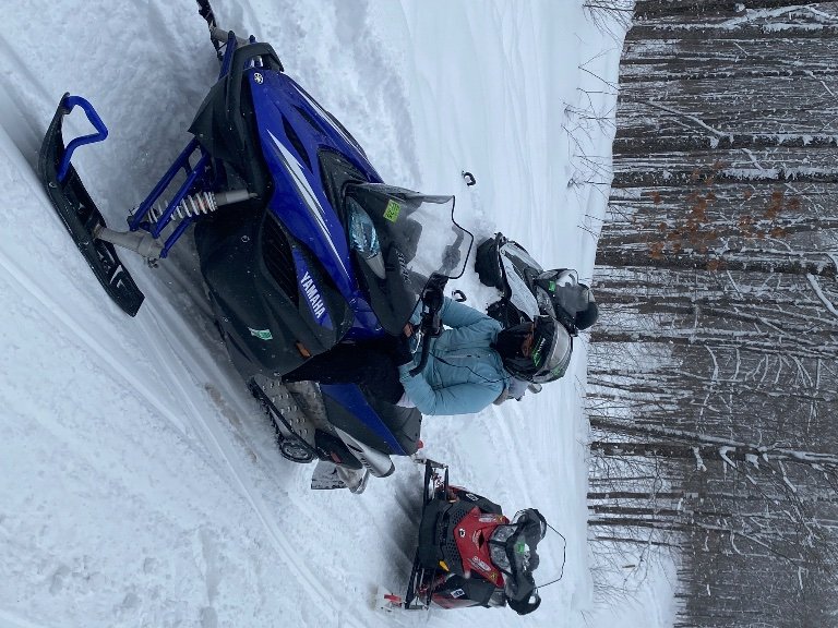

Considering a skid swap for the attack
144 cmotion
137 rmotion
137 sidewinder skid
Maybe a m10 or m20 air wave
Any input regarding ride quality over another, ease of installation etc.? I can’t find any info on the first one..
seems like everyone who does the rmotion swap is really happy with it
Does the sidewinder suspension bolt right up to the apex and if so how does it compare to the rmotion ?
I’m leaning towards one of the 137 options so I can reuse my current track. Trying to keep costs under control.
Thanks guys in advance for the responses. I love riding this sled and plan on keeping it. Just would like a little smoother ride out of it
