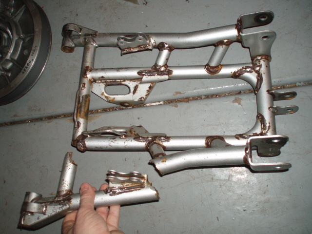

Also check the front arm in the rear suspension - these are prone to cracking and I discovered that mine was broken recently. Look for cracks in the horizontal tube that is high in the tunnel.

Regarding the suspension arms, check out the posts on the Mono Beef UP from Welterracer with pictures - you will see a picture of where the front arm (not the W arm) usually cracks. I have included a pic of where mine broke.
