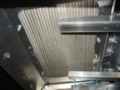

This is a CUSTOM BUILT cooler I made for my turbo sled last year. It takes no room under the tunnel. I started with a cooler from a ski-doo and welded on V-Max-4 elbows to it to get in line with the hoses in back. I had to go to the scrap bin to get what I was looking for. This is how they should be from the factory.

I mounted the mountain cooler with home made rails. Yes, the studs still hit even with 1" stand-off.
I was thinking about cutting the tunnel and mounting from the top with risers so I could leave the OEM rails. I just couldnt get myself to cut the tunnel
