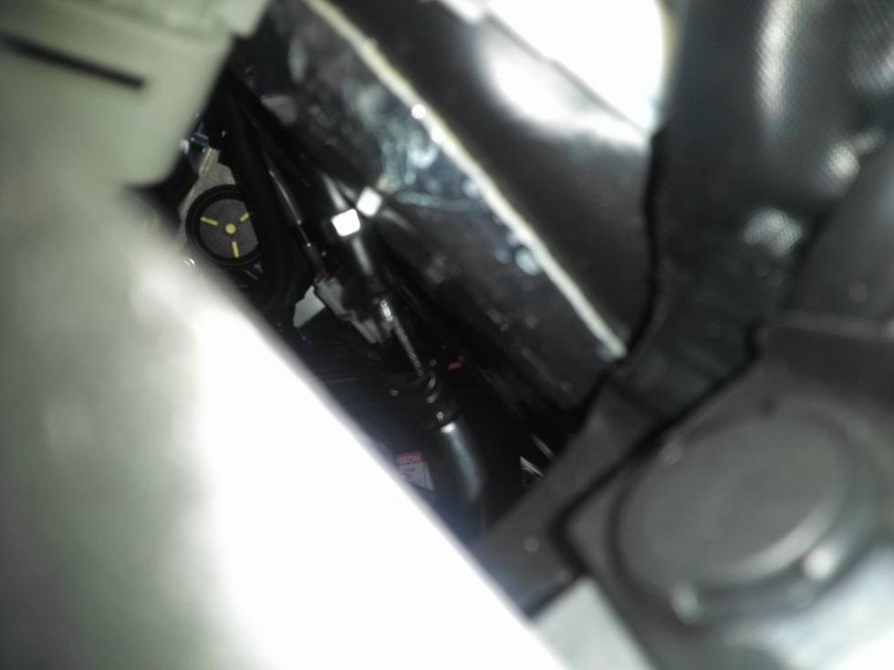

Well I installed 3" risers and i thought the cables were ok but my throttle cable is too short. The TORS started kicking in and i barely made it home. It looks like the cable came out of the crimp at the throttle body. The picture is pretty blurry, but you can see the tape that held it in place (kind of) to get me home. Is the MTX cable longer since it has factory risers. The powermadd extension is 10" and i already need to order a throttle cable so i might as well get the MTX if it is longer.

It will fit you have to reroute your cables, I have an extended riser on my fx nytro rtx

ùi had a 2.5" on mine and never had that trouble. I guess the extra .5" makes the difference.

reroute your cables and move your throttle cable till its at the right angle and you wont have that problem anymore. I have an xtx with oft relocate and the rox 2.5" riser (est. 4.5" total rise) and still have room for more in the cables if needed

i needed a new one anyways so i ordered a MTX cable and will route it as best i can. thanks for the help.
good thing the tors was working. could have ended up with a wrecked sled

These guys are right, stock is more then long enough you have to move it to the front. I have a 4" riser with an OFT relocator and stock cable

...and by front I mean rear.
