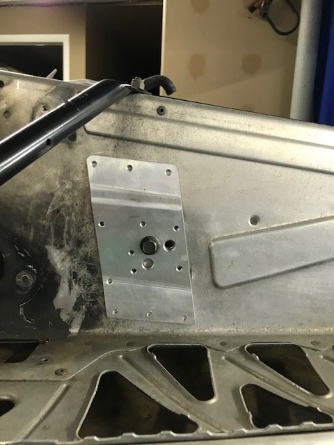

Can anyone post pics of these plates installed?

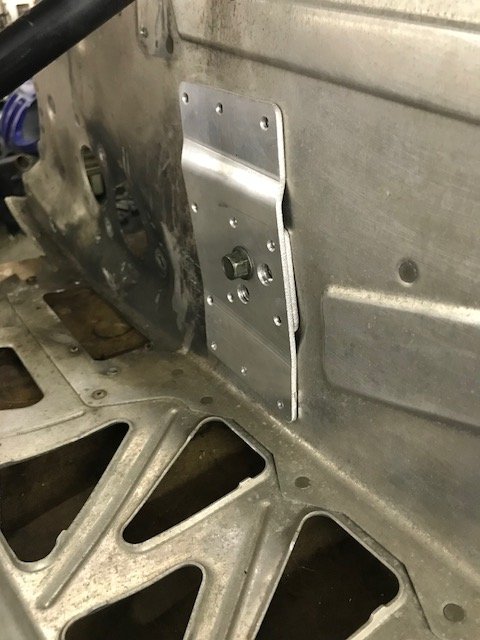

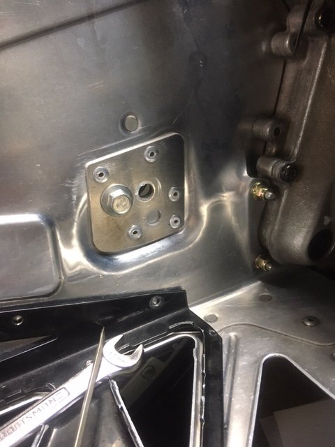

I used a big bolt and washers through the hole to suck the plate in very tight to the tunnel, in the correct position, then drilled and riveted it in place. It’s easy with the skid out. You could do it with the skid in but you would have to remove the forward shaft bolts.

I can take more pictures of you need them.Can anyone post pics of these plates installed?
