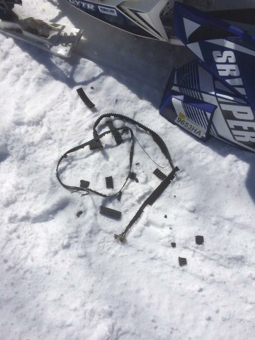

I had 2 8jp belts explode like this on my turbo, 200 miles on each belt. Tried an 8dn for the rest of the season and at 800 miles it just started to pull the cords out. That's running at 7 pounds with a lot of hard launches so I'm pleased with that considering I can get an 8dn brand new for $50. On a side note I ran the 8jp belt the first year on a stock sled with a clutch kit and never had an issue, but they don't seem to like the big hp.

thanks. looks like ill be going to the 8dn next season. it does look like i did ok getting over 2000 miles on the 8jp with the turbo.
