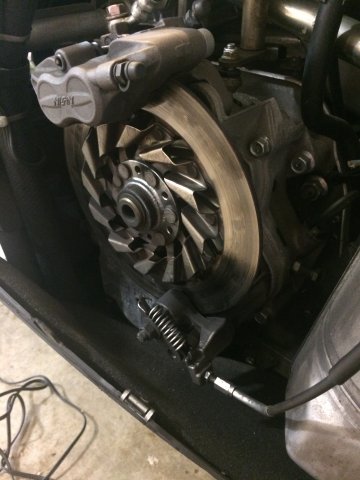

I changed my belt this year with a Yamaha 8dn same oem belt that I have always rode. My first ride out I had belt squeel at idle and running at lower speeds. When I had a look and twisted the secondary by hand it is squeeking which I never heard before. What would cause this it's like something needs to be oiled??

Thought I would add that I removed the belt and when I twist the secondary back and fourth there is a definite squeel on the shaft. Is there a lube point somewhere? Sled was apart at the end of last year with a bulk head change by the dealerI changed my belt this year with a Yamaha 8dn same oem belt that I have always rode. My first ride out I had belt squeel at idle and running at lower speeds. When I had a look and twisted the secondary by hand it is squeeking which I never heard before. What would cause this it's like something needs to be oiled??

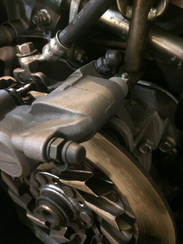

MadMax
They are not grease nipples but brake bleeders.. Use them when you need to change brake fluid etc.. MM.

yea I realized that when I had a closer look....lol

Thanks for all the replys. I meant to post the solution the day after but never got to it. I hate to admit my stupidity but here it is..it was the parking break that was on. Obviously it is a little loose/weak as it did not seem to leg much but I only when around the block pretty much. Once off no more squeel.
