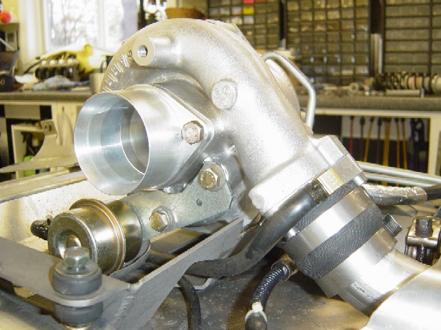

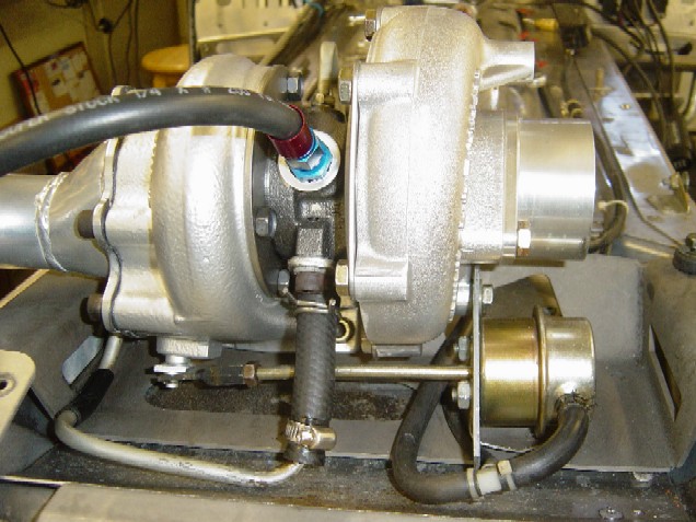

Here are a couple of shots of my conversion to 2560R with Ted's guidance and parts.
Had to make a bracket for the waste gate. No big deal! Added water lines to the turbo in addition to the standard oil lines.

Hey Otis, Ready to move that one to the Front Yet LOL!

Ted Jannetty said:Hey Otis, Ready to move that one to the Front Yet LOL!
Ted
I'll be down 9-17 to discuss the process. I spent this afternoon tearing her down. I'll call you before then.
thinksnow
Does the stock heat shield still fit with that new turbo setup installed? Where did you tie in your water lines? Can you get away with tieing into the running board coolers?

thinksnow said:Does the stock heat shield still fit with that new turbo setup installed? Where did you tie in your water lines? Can you get away with tieing into the running board coolers?
Yes the Heat sheild fits and the water lines hook to the carb cooler lines up front.
