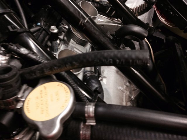

Yes. Check this hose. Maybe it came out of airbox. It vents valve cover.

Perfect. I'll ask the dealer if they checked it.

I do not think its a big enough issue to justify in stock configuration but if airbox is removed and filters added to system I would consider putting a small slit in the vent hoses. This will keep most oil in and if plugged hose it will allow pressure out the slit. Messy though and always need to be concerned about oil and hot exhaust can cause fire. I still lean to improperly installed rubber cam plug in valve cover. Would be huge pressure needed to pop them out and I have seen how fast engine is stalled out when vent is blocked off.

Would oil in the air box from Tipping to one side cause this?

I do. It could overwhelm that hose I pictured. I think all of us should get the updated oil tank or at least buy the 4 stroke solutions rollover valve and use the tether. The tanks and chaincase covers are junk in both design and strength. Yamaha should step up for any of us who have had a issue.
