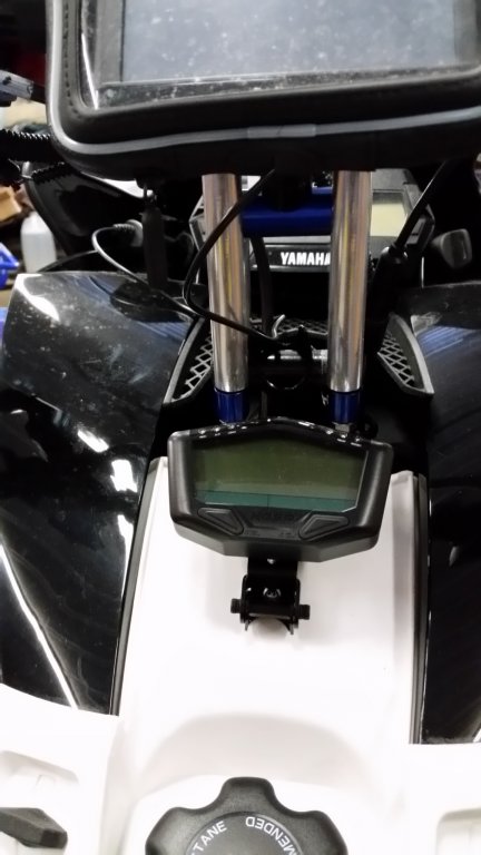

Any more pictures of the Koso gauge during the day? How's display color match factory gauge?
I can try and get some during the day, but it really shows up decent
Wow Terry the Koso is cool looking....yes more pics!
Will do bud!!!

I think I'm going with this gauge can you get a pic so we can see the mounting location better?
Thanks
Thanks
That's how I wanted it....so I can remove the hood without all the wiring.
Koso gauge mounted on the plastic. Can see it driving, racing and even standing up.

Had a migraine yesterday....was home all day.
I will get a picture tonight how it's mounted and where I ran wiring.

I wanted to mount the gauge so I wouldn;t need to take all the wiring apart when removing hood assembly. The boost sending unit is in the hose close to the intake box. The water temp I put with the top hose above the clutching and the AFR is mounted in the EVO exhaust I have. Power source came from the right side panel plug by the oil tank.
Future wiring will be in a wire loom for a neater look.
I ordered the same unit (KOSO) and will be installing soon. Although another member recommended against the KOSO, I did some research and went with it (nice, clean, well lit and visible unit with everything I was looking for and great reviews). Thanks for posting your mount/install application - I'll keep it in mind when I install mine.
