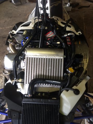

My turbo has a solid bar that goes between the two bolts to support the sheet metal.Your turbo shield is going to crack if you don't put a doubler on it....this was mine without doubler.

I have 2 small plates left over that I could not find instructions for. This must be what you're talking about, do the over or under the heat shield? One for each set of bolts in the shield?
That's what they call a doubler...a half moon piece with two holes in it...you can see it in step 107 here...http://www.mountainperformance.com/Files/Download/mtv-0510_viper_190_all_altitude.pdf
According to my dealer my kit didn't come with it...maybe something MPI added later...who knows? Think they are around $7 from MPI...that's about $100 Canadian once you pay for shipping and exchange...HA!
Hahah thanks a lot I see it now just saved me a few bucks! Thanks again for the info.

My kit came with it.
