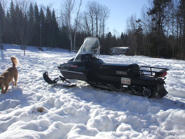

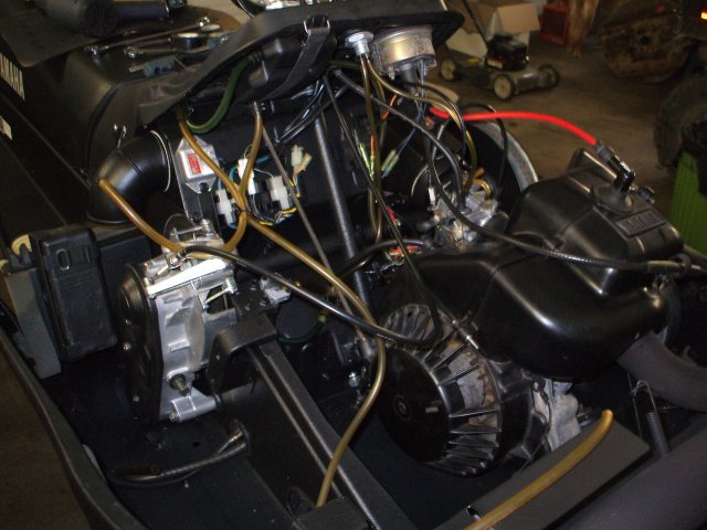

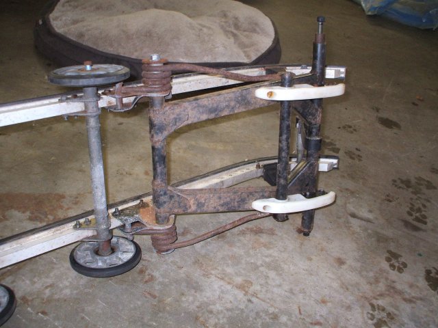

Got this 96 Bravo a few years ago with only 750 miles. It was a DNR sled. I figure it spent alot of time on a trailer as it was pretty rusty.
After sandblast and paint.
Reassembly. The only fasteners that weren't removed were the engine head and case bolts. Everything else was completely torn down, cleaned, and repainted. Alot of hours spent behind a wire wheel.
Finished
Finished
View attachment 118897 View attachment 118898 View attachment 118899 View attachment 118900 View attachment 118901 View attachment 118902 View attachment 118903 View attachment 118904 View attachment 118908 View attachment 118909
View attachment 118906 View attachment 118907 View attachment 118910 View attachment 118911
Finished
View attachment 118912 View attachment 118913[/QUOTE
