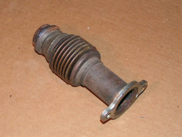

So got it all apart.........donuts don't look to bad but will change them anyway since I have it apart...........one flex pipe is not connected to flange that attaches to motor??????does this mean its hooped...................is it suppose to be one piece?I've also changed one flex pipe without taking the others off to replace the gasket and haven't had any problems resealing it. Just inspect the metal gasket to make sure it wasn't leaking and still has a good sealing surface.

It should be one piece. You can find used on ebay for around $30
