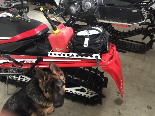

View attachment 124032 I have a 2 gal gas can and a shovel pack on my BTX LE and the tunnel is now bent by the rear of the running boards the sled had 80 miles on it with 50 of them with the gas can mounted. Trails were not very rough I'm not sure if the shorter sleds will have the same problem!
So I just took my mtx on the first ride of the year and the day after I noticed I bent my tunnel just like you had. Did you have to replace the brackets where it's bent before you put the new bumper kit on?

My suspension brackets weren't bent it was all in the tunnel I hung it by the bumper and jumped on running boards till it was straight then c-clamped he sides back straight the best I could and then when I installed the bumper I had to c clamp it to the tunnel to get it to fit tight it looks like brand new now
